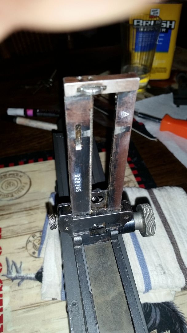

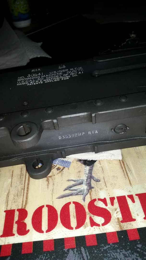

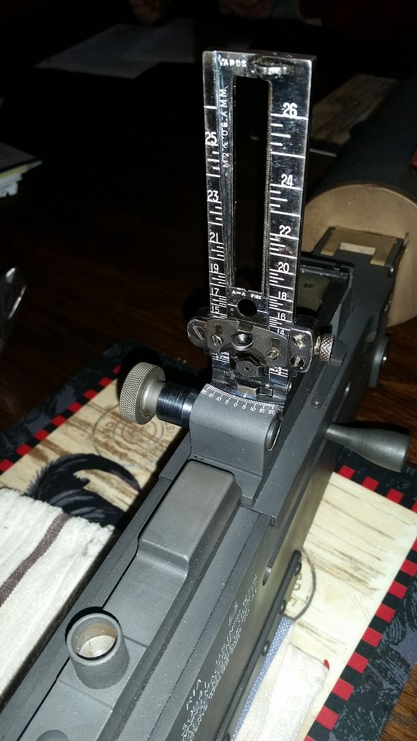

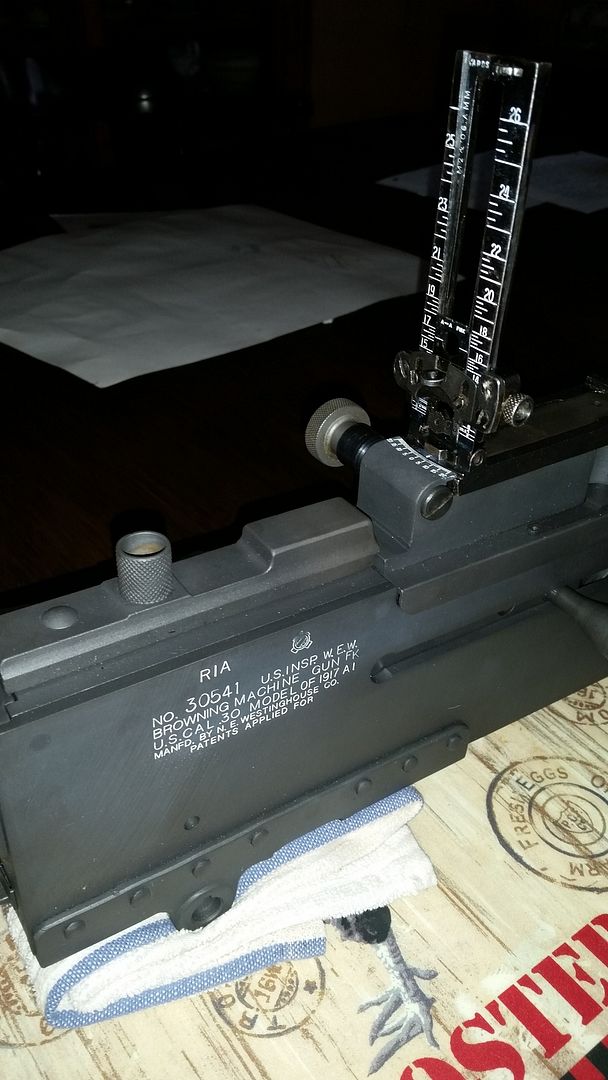

With help from Toolman my long running Westinghouse 17a1 is nearing final completion. I spent a couple hours detailing it today. I am going to swap out the parked Westinghouse internals for my in the white set of internals then I might be done, unless I find something else that must be there:D
Toolman showed me his technique for filling the letters and numbers. I modified what he was doing and it came out fairly well IMOO.
So here are the pics, next task will be detailing the 17a1 .tripod

Looks very nice. The ladder sight turned out really nice!
I'm almost tempted to consider Matt's kit that he has up right now. I always wanted a water cooled version, but alas I'm in the market for a new Silverado right now. My 1999 is starting to age on me. :(
Russ - care to share your technique with me? I've done some highlighting on a few guns, but always looking for a better and easier way. ;)

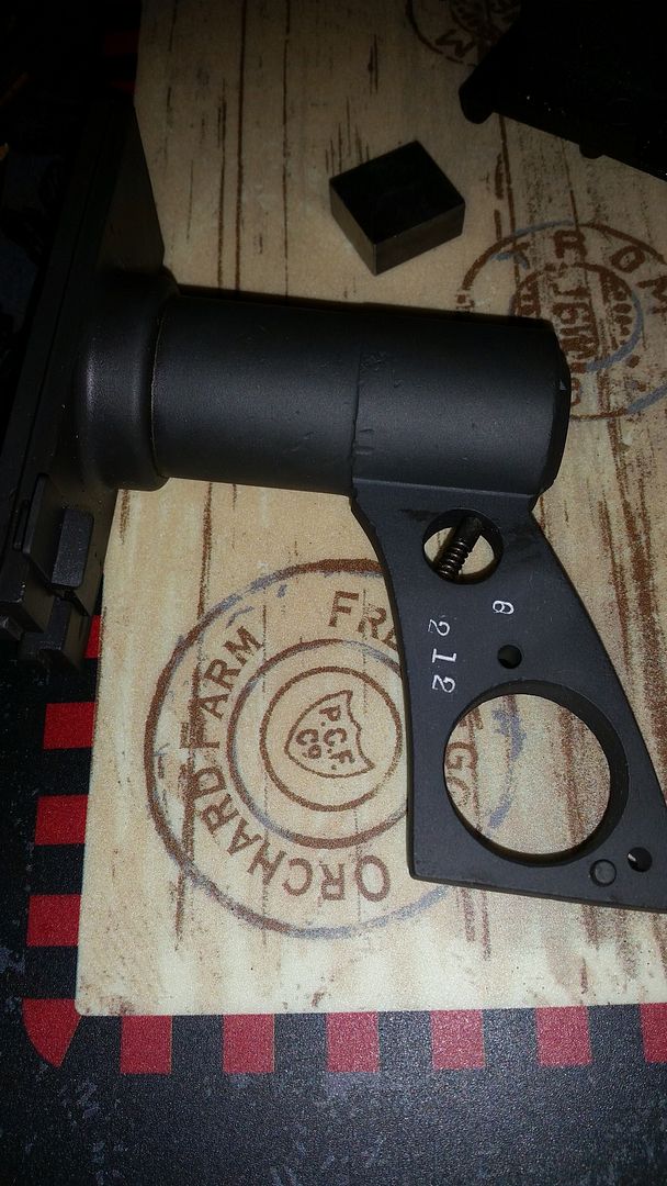

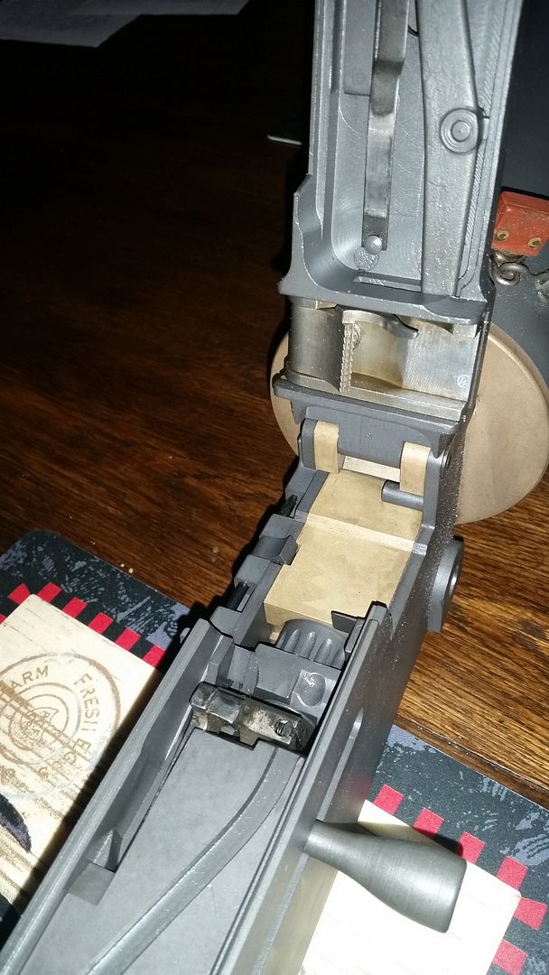

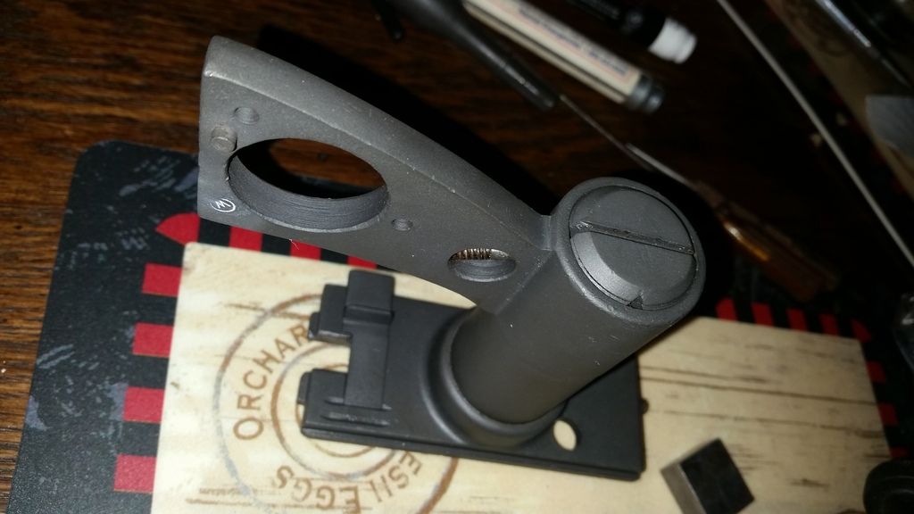

Progress on the tripod. Its dirty from being in my workshop. Sawdust and grease are lovely together.... Need to paint the brass tripod head and I only have an od primer on the legs. The park is the original park that was under the MANY layers of paint from the Greek military so even with stains and dings not intending to repark.
I did clean up the haze on the cradle elevation.

Realized I had not put the carry handle back on it. Trying to remember if it rides best in front of the water fill plug or behind. Need to remember because it would be upsetting to scratch the park having to move it after its clamped down. Trying to figure what I did with my pintle. Sigh. Might be buried on the bench under g3 projects.
Terry I just use the oil based paint markers and over fill the engravings, let dry and use paint brush restorer and paper towel to remove the excess. Pretty simple and user friendly and the markers go a long way unless of course your name is gulfstateguard :rofl::rofl::rofl::rofl:

OK Thanks Russ. That's pretty close to what I do now, so we are on the same page there. ;)

I varied on what Russ showed me depending on how deep the stampings are. On deeper stamps, I filled, then immediately wiped the excess with clean paper towel, only one swipe then fold or use another section then when dry use kleen strip brush cleaner to remove the haze or excess. Only fill about an inch to inch and half at a time then swipe excess. On shallower stamps the wet swipe will sometimes remove too much, on those you can try to either let it partially dry then remove some of the excess with the dry paper towel then wait for it to fully dry. Or so as Russ does wait for it to fully dry then use the brush cleaner on it.
I like getting the excess off earlier, then using the brush cleaner. The key (as Russ pointed out) is never wipe with the same section of towel more than twice.
You will want to start with a fresh roll of paper towels, I found having a box of q tips was good for touchup and getting close to light stampings without removing from the stamping. I twirl the wet q tip to remove the hazing.
Also you only need a little bit of brush cleaner on the paper towel you folded up on itself, you do not want it excessively damp.
I was chatting with the Duke last night and he was concerned about the fill staining the park from his experience with flat paints. If you are filling on park
And do not like your result the brush cleaner will strip it all out so you donot have to worry about screwing it up. If you do, just clean with brush cleaner thoroughly, let the brush cleaner dry, then go after it again. Some areas, markings took me three tries. In some cases I just had to accept, good enough.
