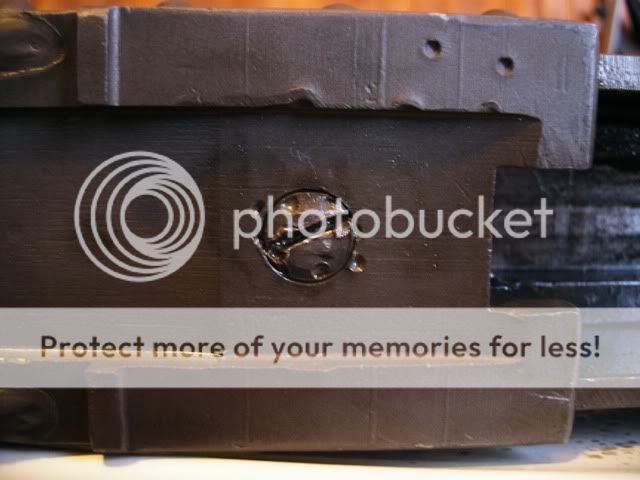

3.) Make sure the lock cam screw is not too long. If it is too long it may be extending above the cam lock causing the internals to catch. BTW, the cam lock should be a little loose. The cam screw should be tightened and then backed off approximately 1/4 to a 1/2 turn and then staked. This is located on the bottom of your 1919.
When the internals are out and you look inside this is what you are looking for. Make sure the top of the screw is not protruding above the cam lock. If it is remove enough to make it flush.

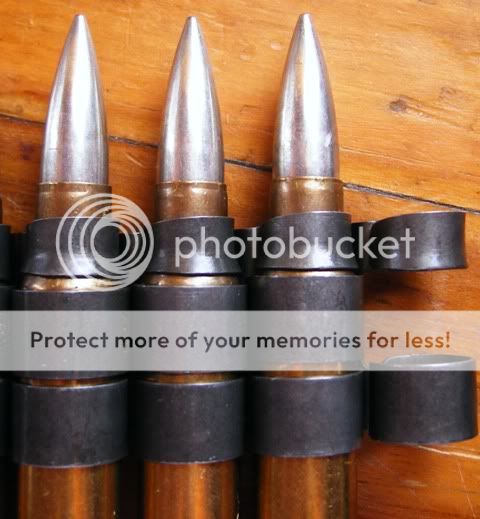

2.) Make sure you are using .308 compatible links in your .308 1919. You can use 30.06 links in your .308. However, if you are using 30.06 links then make sure your cartridges are properly set. If linking .308 cartridges in 30.06 links by hand, push them all the way up and then back them off a couple of millimeters. If using a linker stop just shy of fully seating the cartridges to resemble the placement of the cartridges in the second picture below.
Fully seated (now back them out to resemble the second picture below this one)
Properly set 30.06 links for use in .308 1919

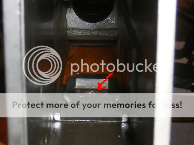

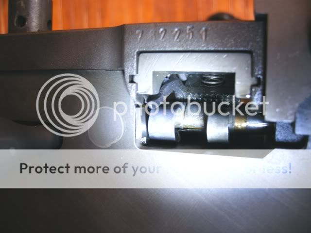

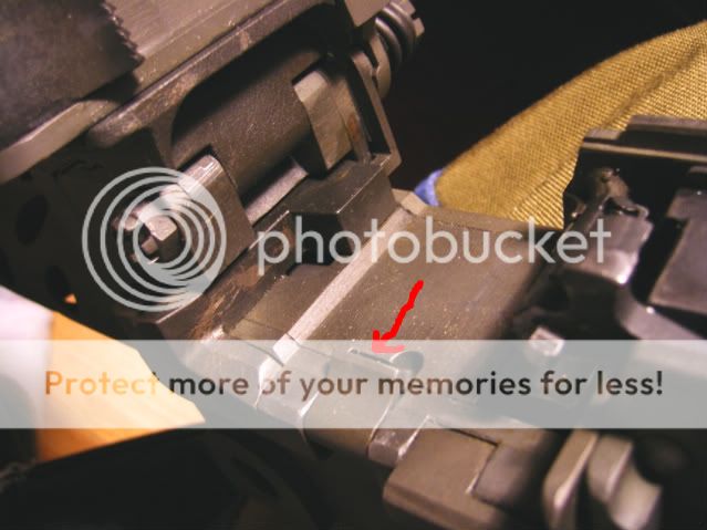

3.) Check the arm on the belt feed pawl. Sometimes these can be bent foward a little too much. When not properly aligned they will rest on top of the links instead of falling behind the link and resting on top of the cartridge. The feed pawl must seat properly in order to push the linked ammo into the gun.
Arm on belt feed pawl.
Feed pawl arm resting on link (dont want it to do this)
Feed pawl properly resting on cartridge.

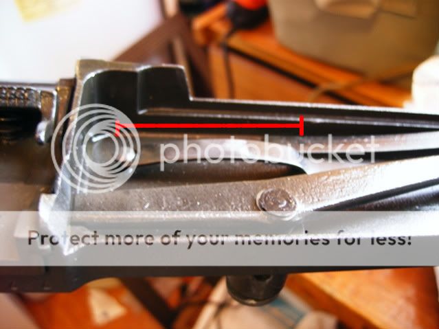

4.) Check the feed pawl spring tension. There should be adequate tension on this spring.
_________________________________________________________________________________

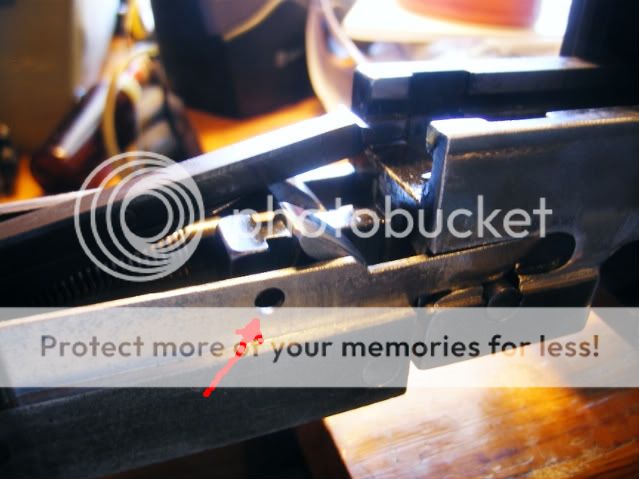

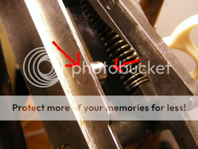

5.) Check the top cover extractor spring. It should look similar to this. If not, remove it and carefully adjust the highlighted area.

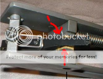

6.) Check the belt holding pawl spring tension. It has been pointed out to me that the springs in many of the Izzy .308's are too stiff and cause feeding issues. If all of the above have yet to fix your feeding problems you can remove the holding pawl and remove the spring and then try shortening it by one or two coils. I dont know if I'd recommend removing more than that.
