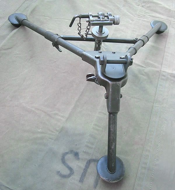

Here is my USGI 1970 M122 set up for the A4 - (the mounting pin and chain are for the M2HB .50)
