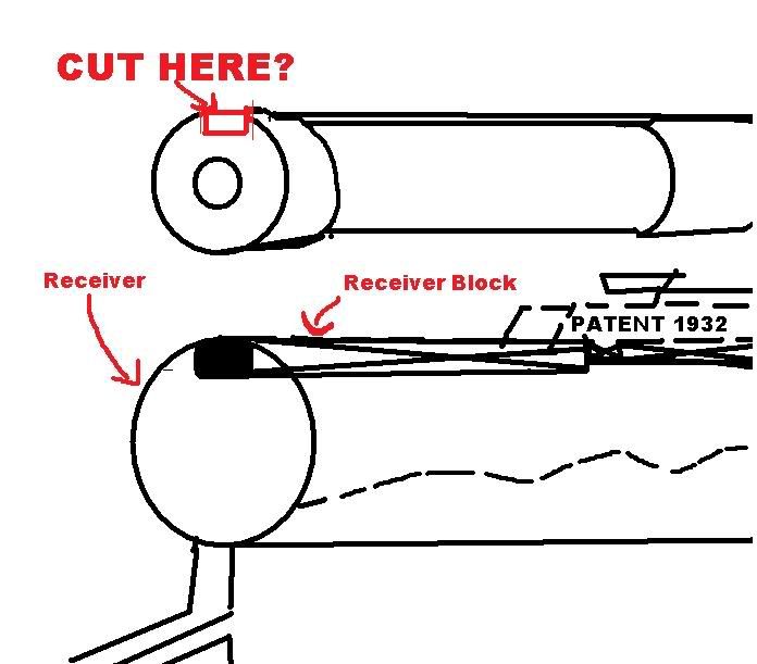

now id like to use a rewelded receiver, it seems the semi auto bolt prexis makes its only for his reduced receiver, i would like to come up with one that has a block instead of a reduced dimension. i can save $150 right there. least ive got something to work with now.
at this point its more about what i can afford.
i think ill go reweld i was thinking using a full length block that will also act as holder for my reweld, after i fix the ppsh tomorrow with your help the next day or this weekend i think ill start on the fitting together and weld prep. and see where that takes me. going to use gregs trigger set up. as for the bolt... i don't know yet. AR15 firing pin? got some designing i need to do i guess. but a simply will out for the block similar to the ppsh bolt but more like a guide rail will do i believe
now theres already a guide rail on top on the receiver where the cite base fits onto it. perhaps i can do something with this.
picture example.
what you all think?
