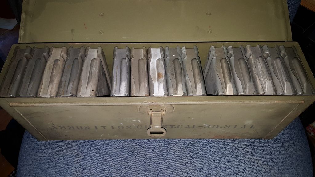

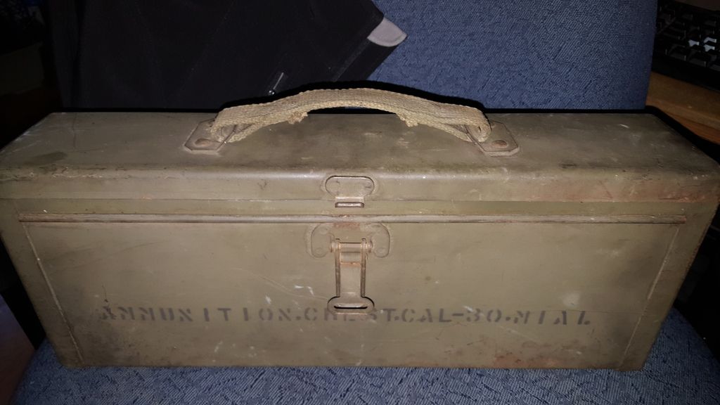

Well after a year searching, landed an original bar mag chest. I'll get pics of it when I get the goop off from army tape used for long term storage.
Pics are of one almost same condition.

It's really becoming an addiction, that's aging up quick that's for sure. Thankfully picked up a bandolier for it, for $5 cause guy didn't know what was to.
