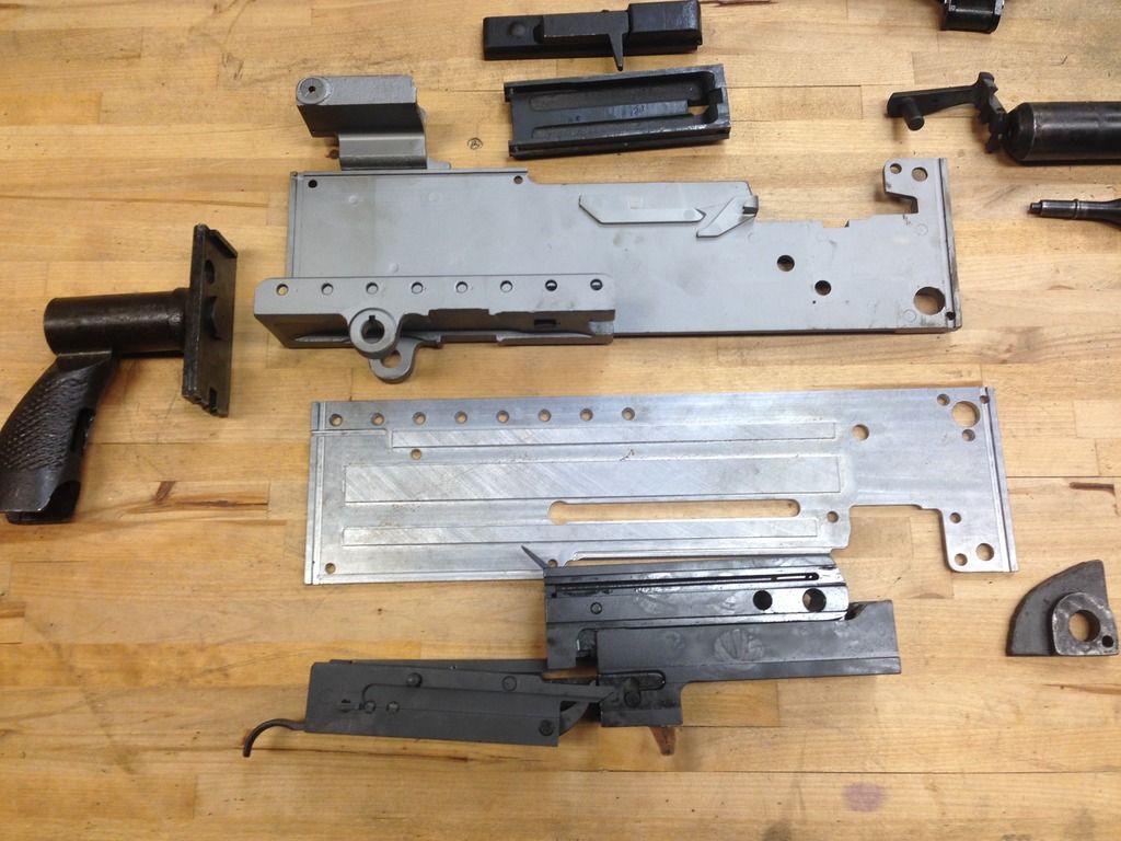

I just got my kit today! Joyous occasion! I took pics after I got everything apart and lined up (mostly). Impressions. Nicely made. The box is aligned perfectly to begin with. No issues there. Rivet holes are drilled and countersunk just perfectly. A little deburring needed on the trunnion (Israeli surplus). Barrel, bore and chamber are really nice and bright. All parts look excellent.
I'm mainly putting this out there so anyone who gets one of these can see what they're getting better than OOW's stock photo.

Great looking kit kahnmann, nice to see there are still some nice ones out there. OOW has always been a great source for parts, Bob Landies has gone out of his way many times locating obscure items I needed.
Your pictures are nice and clear and it helps show the details that a great kit has. I am sure f you take your time this will turn out as good or better than the day it was manufactured. Good luck with your build, but like potato chips I bet you won't stop with just this one. Keep us informed as to how your build goes. :thumbup:

Yup - kit looks real nice. Post pics when you finish it up - I think it will look even nicer at that point! :D

You can see on the sideplate that OOW still uses the old style of three denial islands. Parts won't interchange with the newer single island plates.
The advantage of the three island is that the finger on the right side of the barrel extension that unlocks the bolt in recoil keeps its original thickness and strength.
