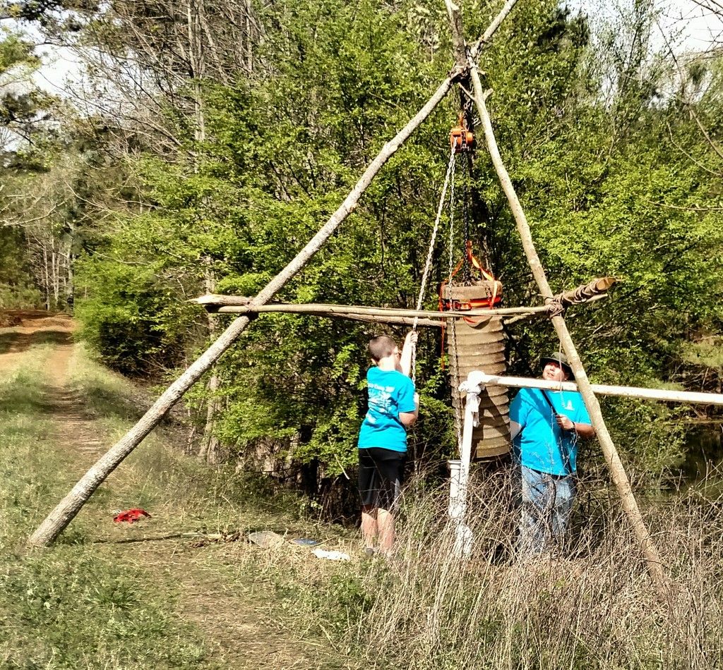

Then I had to figure out how to pick that heavy beast of a tile up and then lower it over the PVC without breaking anything. Oh, I have no backhoe. Other than a famall 140 I am the only other "heavy" equipment around here :rolleyes:. So I broke out some primitive technology and cut some young straight poles and made a tripod to which I attached a 1 ton chain hoist. Here is where the pics begin.
This is my oldest, Michael, and my middle girl Katie waiting to help.

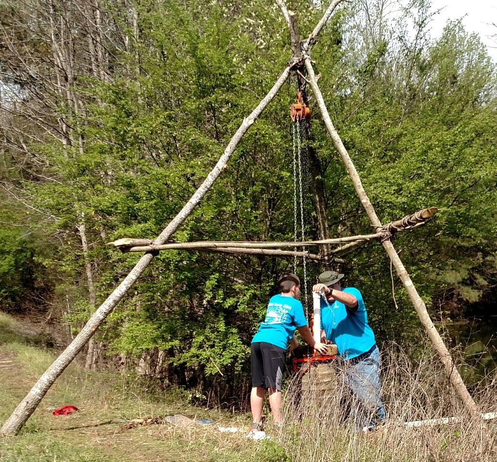

This is Michael hoisting up the tile while I hold it back away from the PVC. The horizontal piece of PVC is keeping the water, which I can't stop, flowing out into the pond so that the hole does not fill with water. It also kept the work area from becoming so muddy.

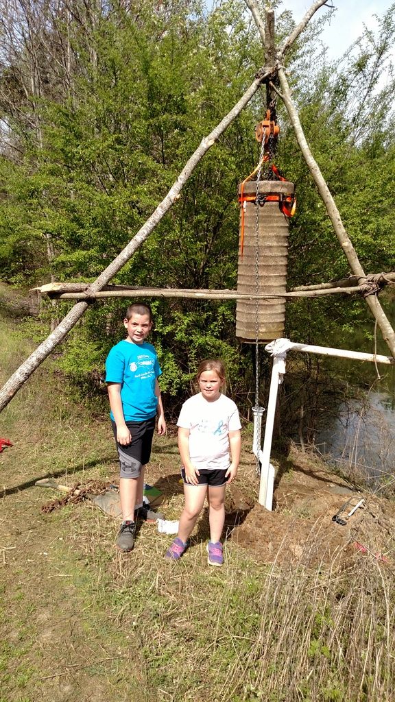

This is the kids posing with the tile. We had the hoist maxed out. I was just high enough that when I took the elbow off the top it would swing right over. I took lots of pics so that the kids would have memories of the work that went into this, and proof if they ever want to tell their children or grandchildren that they helped do this.
Here we have the tile lowered into position and are trying to center it.

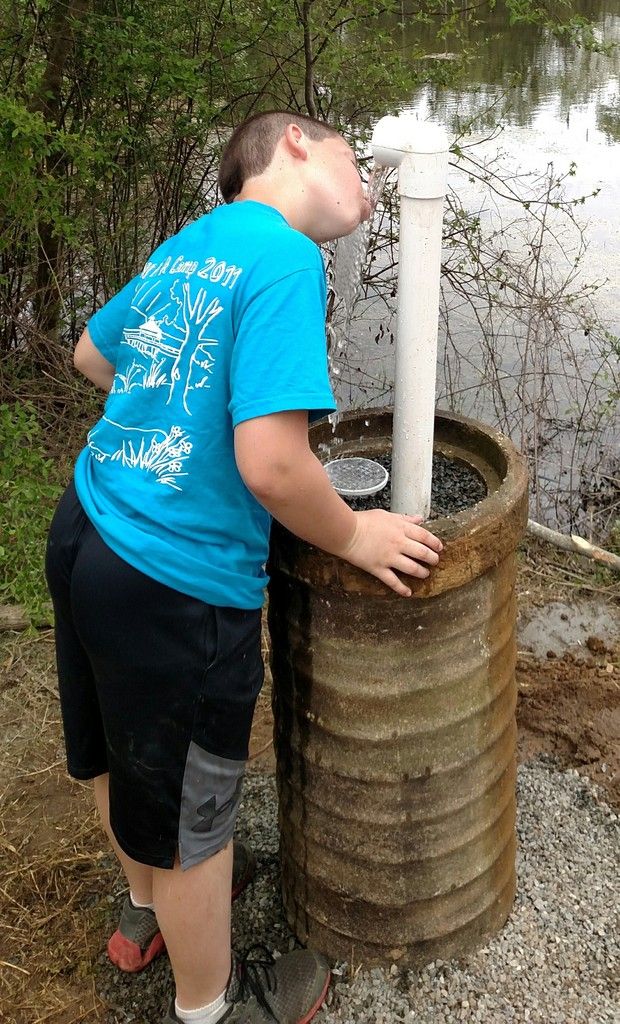

Once the tile was in and mostly plumb it was filled with gravel, and the kids had to have a taste. It is cold, and tasty!

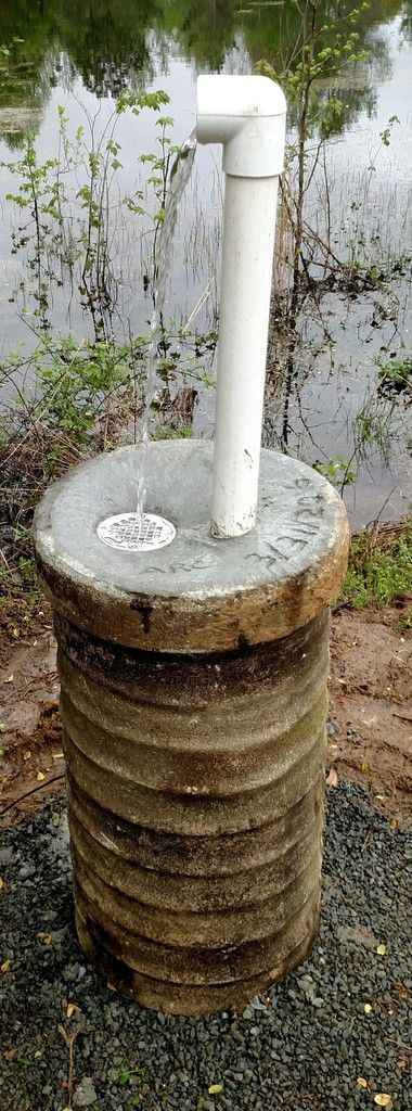

After the kids drank their fill, I poured concrete in the top of the tile over top of the rock and finished it into a bowl so that the water would drain back down into the pond. I put a short piece of PVC on the top to keep the water from messing up the concrete. After two days of curing, here is the finished fountain! Free, clear, clean, cold, and continuous H2O!

You might consider some kind of cover or casing for the PVC neck that is exposed to sunlight. Out here white schedule 40 turns gray and becomes very brittle when exposed to UV light.

Oh, as far as the UV on the PVC. I am considering making a spring house, or at the very least a spring cover over this. I want to build a small deck around the concrete tile to make it level. It would look nicer too. However, I have so many projects running right now, that it might take another 5 years to get that done. But hey, it's like I tell my wife. I could be spending my money and time on gambling, drinking, drugs, women, or beltfeds.....she said "Ohhhh Nooooo! ANYTHING BUT BELTFEDS!" :tongue:
