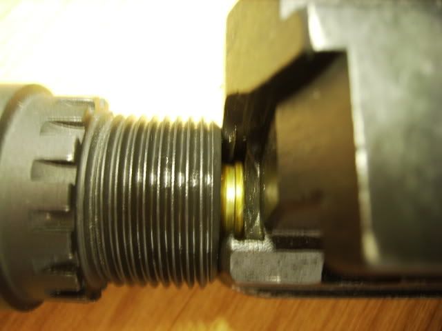

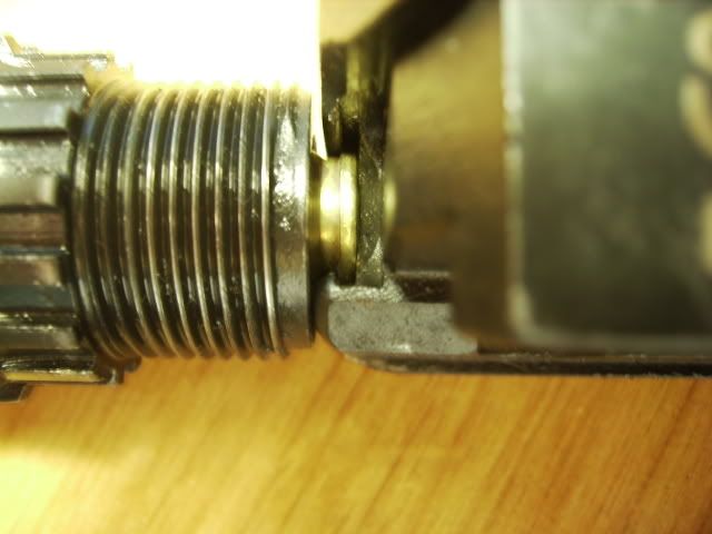

I got my new 8mm barrel and started to heapspace it. I set it to lock up and then I when one click out. I loaded a romy round in the the bolt closed all the way. So I moved the barrel back to lock up (0 clicks out) and load up another romy round and the bolt still closed. With the bolt closed I took a small screw drive and I could move the round forward and backwards about 0.010" I tried some 80 yugo I had and it was the same thing. So I put all my .308 stuff back in and ran it out two click and loaded a round. I was not able to move the round forward and backwards with my screw driver. I've attached two pic one of my .308 barrel and round and one of my 8mm barrel and round. In the .308 pic with bolt pushed all the way forward you can still see a small gap between the extractor lips on the bolt and the barrel. On the 8mm pic the bolt is pushed forward all the way and the extractor lips are hitting the barrel and the round is still loose. Is this chambered to deep?. Is it safe to shoot. I don't think it is safe. I've though about removing 0.020" off the back of the barrel. I wouldn't be cutting into the chamber. It would just have a smaller radius leading into the chamber. I'm going to contact the manufacture before I do this. I had to use up the last of my .308 ammo today :( Is this normally for 8mm barrels? What do you guys think? Thanks

This brings up a point that I talked about earlier on another thread. A way (perhaps not the best but it works)to check for a deep chamber is, with the barrel out and the chamber clean, drop in a cartridge and check the distance from the face of the barrel to the end of the cartridge head. Check it against a barrel known to be good. I've got a USGI 30-06 barrel that measures .123 and functions perfectly at 2 clicks out. My 8mm barrel measures .115 and functions perfectly at 0 or 1. If the chamber is deep, it may tend to split the necks on cases. Additionally 1919s are designed to run really loose. you're not shooting a target bolt gun. All this to say, that you might have a really deep chamber and the other question was already stated. "Who made it?"
